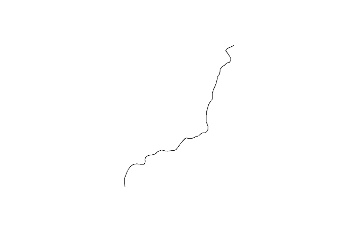

# store and view the results
res <- job$results
res
#> $param_name
#> [1] "OutputTraceLine"
#> $data_type
#> [1] "GPFeatureRecordSetLayer"
#> $geometry
#> Simple feature collection with 1 feature and 6 fields
#> Geometry type: MULTILINESTRING
#> Dimension:     XY
#> Bounding box:  xmin: 438895 ymin: 2422310 xmax: 443325 ymax: 2428045
#> Projected CRS: NAD83 / UTM zone 4N + Unknown VCS
#>   OBJECTID PourPtID               Description DataResolution LengthKm
#> 1        1        1 NED 10m processed by Esri           10.0 9.489823
#>   Shape_Length                       geometry
#> 1     9489.823 MULTILINESTRING ((443325 24...
# plot the resultant geometry
plot(st_geometry(res$geometry))
